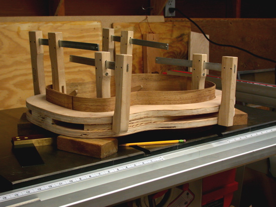

Earlier this year I said that this was going to be the year I stopped dragging my feet and actually start building my first guitar.
I have been to the dump and made room in the shop. Built a bench, well almost. I still need to put the vise on it.    But I'm making progress and I have a picture to prove it.
I'll work on the bending form this weekend, well, unless life gets in the way of my plans.

I do have a concern, but it might just be the photo, the form looks a little thin to me. My first built form is tooooo thick, but it works. My second, I made so that the neck end of the sides stick out about an inch. Plenty of support for the spreader braces inside and enough clearance to install kerfing and glue on the top and bottom.    Anyway, I'm old and quite often wrong, so don't listen to me. I'm just happy for you that you are finally making headway and sawdust!!!!

That is an awesone form! You might want to cut some of the corners off to lighten it up, it is amazing how often you pick thaht thing up and move it around.

Its two layers of 3/4" birch ply. I haven't decided if its too thin or not. I'm still debating adding another layer or two.

As for the form, I am planning on clipping the corners, as soon as I figure out what I'm going to do.

i generally make my molds three layers thick. i found four to be too thick. but i feel 2 to be too thin though i have never tried it.
i would trim it a bit though. you don't need all that material on the sides which serves no useful purpose. make the sides have about the same amoumt as the ends. will make it easier and more convenient to handle, require less bench space in use as well as taking up less storage space.

Two more layers Lilian, make it 3" thick. I think that is what mine is. I gotta get back to the game...only about 4 minutes left and Vancouver is only up by one!

If you haven't stuck the layers together yet, you might just add spacers between the two layers you've already cut. Keeps the weight down.
Like this, it's three layers of 3/4" birch ply, same as John Hall's excellent forms. Thicker might be nice, though.

Great work Lillian! I have to agree with Michael, 3 layers of 3/4" board. IF you go 4 layers thick that will make your mold 3" total thickness, that is OK for thicker bodies, but on say an OM where the neck is only 3 1/4 or so, it gets kind of hard to get the linings clamped in place. Don't ask me how I know this
